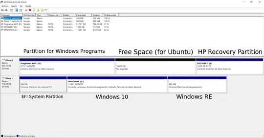

This is how my disks and partitions look right now (Disk 0 is the HDD and Disk 1 th SSD):
Disks and Partitions
My intention is to install all that has to do with Ubuntu in the non allocated space. I'm imagining that, if something like that could be posible, I might be able to delete those partitions (independent from the Windows's ones) and pretend nothing happened there. The unallocated space size that is shown in the screenshot can be more than 100 GB if needed. Comments said I was using and outdated partitioning scheme, so I will check that again.
