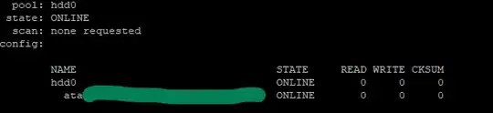

I have one HDD formatted as single disc zfs system on my server. It looks like the following: enter image description here
Now I want to convert this to a zfs mirror without formatting the original disk. Any ideas?
Result should be something like:

I reproduced your case in a VM and paste here step by step. :)
Note: First of all, please do a backup of your data. I added an empty new disk, so ZFS had no doubt what was the master drive. Although you should have no problem as the first drive already forms part of the pool, a backup is recommended.
Quick answer: You need the zpool attach command.
Basically: sudo zpool attach hdd0 existinghdd blankhdd
After, do:
zpool status
And you will see that a mirror has been created. Your data on the already existing drive will be kept, and will be replicated to the new one. This process is known as "resilvering" in ZFS.
As ZFS only copies the actual information this process will take more or less depending on the amount of data. In my VM 300 GB were replicated in 3 seconds, while my experience with SAS and SATA drives, I was resilvering 10 TB in less than 24 hours (for that I was using drives from 10TB to 14TB SAS) .

zpool attach hdd0 id_of_mydrive id_of_the_drive_to_add
zpool status will show:
pool: hdd0
state: ONLINE
scan: resilvered 301M in 0 days 00:00:03 with 0 errors...
  NAME                            STATE   READ WRITE CKSUM
  hdd0
    mirror-0
      ata-VBOX_HARDDISK_VBa8...   ONLINE     0     0     0
      ata-VBOX_HARDDISK_VB8c...   ONLINE     0     0     0
errors: No known data errors
I verified the checksums.
zpool list will return as well 99GB of space available, as two drives of 100GB are being used in mirror.
So as kaulex mentioned the format is: zpool attach
where device is your previous vdev with data (the single hard drive with Data in the ZFS pool named 'hdd0').
As I did you want to use the device ID of the device and not the device name, so you will use the identifier in /dev/disk/by-id/ and not sdb, sdc... (Please note, adding /dev/ is not necessary). The reason to not use device names like sdb, sdc, sdea, etc... is that those device names may change while the OS is running live or between reboots. However the device ID never changes. In real systems, not like in Virtual Box VM's, the device ID's may start with wwn.
