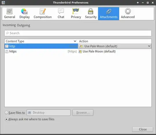

14
In Thunderbird 11.0.1, it is simple, yet not intuitive:
  1. Go to Preferences (Menu EditPreferences).
  2. Click on the Attachments tab.
  3. In the Content Type and Action section set HTTPS, HTTP, and FTP to Use google-chrome (or other desired browser).
That worked for me after trying numerous things in terminal that did not work.

There is one other Thunderbird setting you need to check.
Preferences - Attachments - Incoming
The http and https settings there override the OS default and telling Chromium to make itself the default browser.
See this bug: https://bugzilla.mozilla.org/show_bug.cgi?id=724461

mplong
-1
I also had the same issue. And the "network.protocol-handler.warn-external.http" change did not work for me.
After some Googling i found the setting in the thunderbird preferences > Attachments > incoming.
There i changed the http and the https to the browser of my desire. And it works now.
