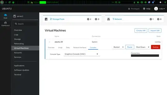

Vnc web console with password enabled in /etc/libvirt/qemu.conf shows connecting but does not load. enter image description here

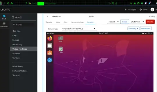

Vnc web console with password disabled in /etc/libvirt/qemu.conf allows connection. enter image description here
