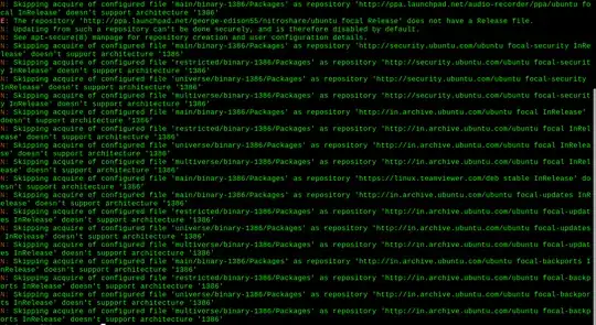

I'm not being able to update with apt update command. I'm getting an error which says:
Skipping acquire of configured file 'universe/binary-1386/Packages' as
repository 'http://in.archive.ubuntu.com/ubuntu focal-backports InRelease'
doesn't support architecture '1386'
Screenshot of Error

you should replace 1386 to i386, it's an I, not an 1.
