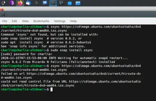

I've been using zsync for the last few months in order to keep up with the daily lives and recently the link for the zsync file for ubuntu studio has been causing an error in konsole.
Thomas Ward
  • 78,878
This is a known issue with trying to HTTPS the zsync file. Not entirely sure WHY, but zsync doesn't handle the https protocol nicely.
Pull the zsync file down without HTTPS - the http link works fine.
