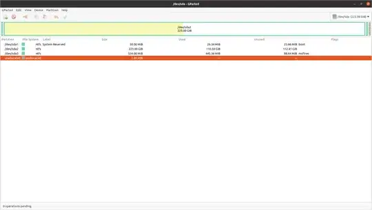

Screenshots of the drives - sda and sdb - from Gparted are shown below: Screenshots of the drives - sda
Screenshots of the drives - sdb
The first drive - sda (a 240 GB WD Green SSD) has Windows 10 installed in it. The second drive - sdb (a 500 GB WD HDD) has an NTFS partition with about 370 Gb allocated, then 512 MB ESP Partition which I had to create when installing Ubuntu 20.10, and the rest about 98 GB is ext4 with Ubuntu 20.10 installed. The GRUB is installed in sdb (it would not install on sda when I was installing Ubuntu 20.10)

Clone a Ubuntu OS Partition from a Dual Drive Dual Boot set up to new SSD
  • Preferably unplug your Windows drive sda, (you can't break what is not there).
  • Plug in your new 480GB SSD
  • Boot a Live or Persistent Ubuntu USB, (made using Rufus, Etcher, mkusb, etc).
  • Open GParted, Create a partition table on the new drive of the same type, msdos or gpt, as the old Ubuntu drive.
  • Select the EFI partition you want to clone, right click and select Copy.
  • Select the SSD, right click and select Paste. Locate the partition on the left side.
  • Repeat with the 97GB OS partition. You can make it larger if you wish
  • Apply All Operations
  • Install Grub. Assuming sdx1 is the esp partition, I use:
    sudo mount /dev/sdx1 /mnt
    sudo grub-install --boot-directory=/mnt/boot /dev/sdx
  • When done unplug the HDD to test the new drive. Note that the old set root='hd0,msdos5' in your grub.cfg file should be changed to set root='hd0,msdos2'. Also note that the HDD and SSD now have duplicate partitions with Duplicate UUID's. If you wish to keep the HDD as backup you can use GParted to change the UUID's.
  • Plug in the Windows drive, boot the Ubuntu drive and run:
    Sudo update-grub
to add Windows to the new boot menu.
