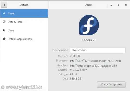

On Gnome 3 based distros (Ubuntu by default) open settings and click on the details and choose About:
reference

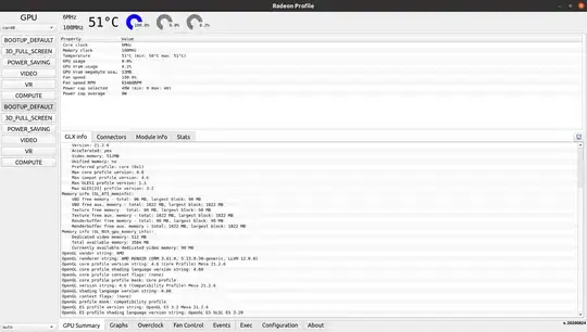

You can use radeon-profile application.
I answered it here.
Output screenshot:
