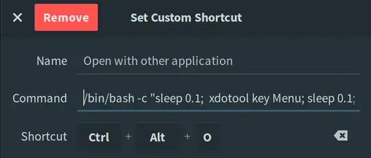

Based on vanadium's answer, I got the idea to create a shortcut to trigger this shortcut sequence:
/bin/bash -c "sleep 0.1; xdotool key Menu; sleep 0.1; xdotool key a;"
(This answer explains the need for bash -c)
Add this to Settings > Keyboard shortcuts > Custom shortcuts > +
