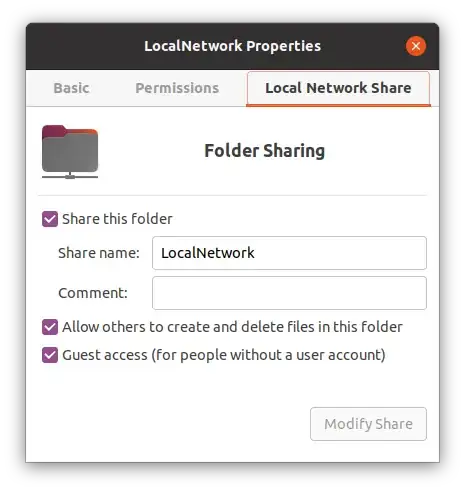

My ultimate goal is to configure an HP Officejet Pro 8600 to save scans into a shared folder on my computer (using the "Scan to network folder" functionality of the printer).
So I have configured a folder on my computer as a network share in the following way:
screenshot

As it turns out I have an HP8600 in my network and I couldn't reproduce your problem when I set the Network Folder on the HP to a Xubuntu 18.04 machine.
But I did get the exact same Connection Refused error when I tested it against an Ubuntu 20.04 machine.
It would appear that either because of its age or the method it's using to connect to the samba share it is doing so using the 1.0 version of the SMB dialect. There is no SMB1 ( samba calls it NT1 ) on the server side of Samba in Ubuntu 20.04 ... but you can enable it if you want:
Edit /etc/samba/smb.conf and right under the force user = your-user-name that I suggested above add this one:
server min protocol = NT1
Then restart smbd: sudo service smbd restart
You may need to reboot the ubuntu box. Now I can send it to the Ubuntu 20 share.
