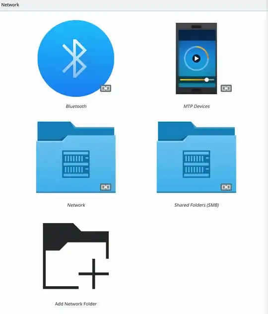

On the left hand side of the Dolphin window, click Network. There will be a item for adding a network location like ftp or scp. Dolphin is a great file manager...

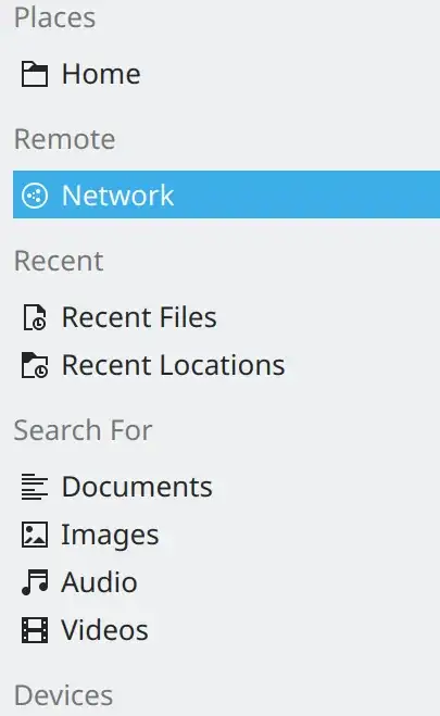

  1. On the left hand side of the Dolphin main window, is a network link
  2. Click on the network link
  3. There will be a symbol for adding a network folder, double click it and a pop up window will happen.

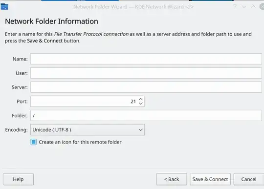

  4. Select ftp option from the list and another new window will pop up.
  5. You are now at the Net Work Information place. Type a name for your network folder.
  6. Next enter your user name.
  7. Then enter the server name. (Enter the server I.P address instead)
  8. Press the save and connect option.

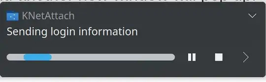

  9. A pop up will appear for password
On the left hand side of the Dolphin main window, is a network link enter image description here
Then on add network folder. enter image description here
If secure SSL encryption is activated on your server, can use the secure shell option to login instead. enter image description here
Use I.P address, not site address, use the number. enter image description here

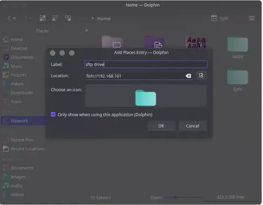

Here is how I have done it that after a lot of searching. Go to Dolphin, right click to add entry, and then type fish://<ip> like we do in Nautilus.
screenshot of Dolphin connecting via SFTP using the fish:// protocol
You can read about the fish:// protocol here: Files transferred over shell protocol
