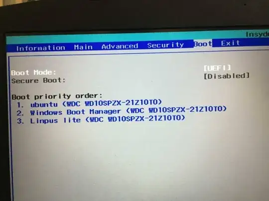

I have a Ryzen 5 2500U laptop with a laptop BIOS (ig UEFI). Right now there are 3 boot options. Windows bootloader, Ubuntu (which is a remnant of an older installation (I think)), and something called Lupin. When Lupin is on the top and my external hard disk is connected (which has Ubuntu and another partition with some data on it (NTFS)) it asks me to boot into Ubuntu or to Windows. But my problem is that when I disconnect it, it just presents me with the GRUB command line thing and the only way I can boot into Windows is to go into the BIOS and change the boot priority.
I just want to configure it in a way that whenever I boot when my hard disk is connected, it should boot into Ubuntu. But when it is not, it should boot into Windows without hassle.

The Ubuntu installation is in an external USB hard drive (sdb) and sda is my internal SATA HDD.
Here is a pic of my BIOS:
BIOS
