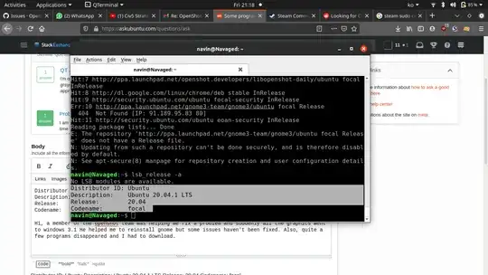

A member of the openshot team was helping me fix a problem and suddenly all the graphics went to Windows 3.1 He helped me to reinstall gnome but some issues haven't been fixed. Also, quite a few programs disappeared and I had to download them.
As seen below, the terminal appears 'old.' Before it was beautiful and purple. There was a hamburger menu in the right corner. Various icons now also look old fashioned, but some things are back to normal. Sorry that I don't have more info, I was just following his suggestions blindly and don't recall what happened exactly.

The terminal is not GNOME Terminal at all. It looks like the terminal from the LXQt desktop environment.
sudo apt install gnome-terminal
sudo apt remove qterminal
I also see Discover, which is the app store from the KDE Plasma desktop environment. It looks like you mixed a bunch of DEs, which is not recommended, and you may want to remove it with
sudo apt remove plasma-discover
I think you likely also reinstalled the normal GNOME Software app, instead of the variation of it that Canonical created to support snaps.
sudo apt remove gnome-software
sudo snap install snap-store
You can also try these commands:
sudo apt remove kubuntu-desktop
sudo apt autoremove
