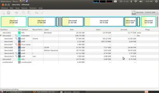

Is there a workaround for this problem? Attaching a screen shot of my hard drive partitions : enter image description here
/dev/sda11 is the one that has run out of space.
Your root partition seems to have more disk space. Boot into recovery console, mount /dev/sda10 and /dev/sda11 somewhere, copy all data keeping permissions from /dev/sda11 to /var directory on /dev/sda10.
Then edit /etc/fstab to comment out the line which mounts /var. Reboot. Have fun.
To prevent this from happening in the future, I would then delete /dev/sda10 and resize your root partition to use those additional 2.8Gb. There's really no benefit in having a separate /var partition if you have that little disk space.
