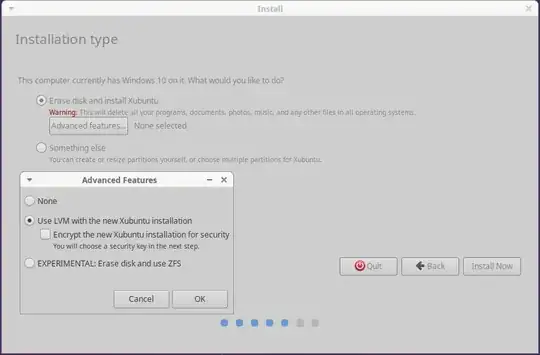

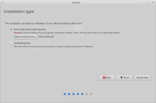

I have just installed Xubuntu 20.04 using a Live USB drive made with Unetbootin-700.
I used the Installation Type Option Erase disk and install Xubuntu and the installation went as planned.
Manual partitioning was not required.
  • From Unetbootin menu select Install Xubuntu, (if 20.10 select Default, then Install Xubuntu).
  • From the installation menu select: Language, Keyboard, Network and Updates preferences.
  • From the Installation type Screen select Erase disk and install Xubuntu.
If you want LVM and Encryption or an Experimental ZFS, the select Advanced features.
