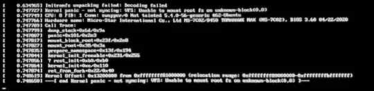

I have had occasional problems in the past where the system would enter a kernel panic on boot, complaining first that initramfs decoding failed followed by being unable to mount root. The recovery mode option for the same kernel version would also panic, although with far more messages displayed.
I would usually deal with this by selecting an older kernel, which would boot fine, and then run Boot-Repair. I would then be good for a random number of boots until it all started over again.
I was never able find the cause and just dealt with the occasional inconvenience, however now none of my kernels boot. All I can do is boot from a live USB. I updated the GRUB config from inside a chroot, so now my Windows menu option is also gone.

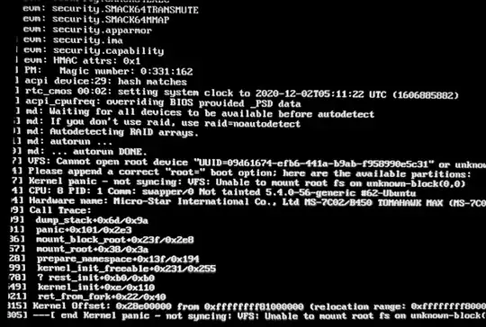

The recovery mode messages ask me to specify my root partition with the root= boot option, and then says here are the available partitions followed by a kernel panic message. It seems that it is not detecting any partitions at all. This seems confirmed by the message that it can't mount root fs on unknown-block(0,0) indicating it can't identify what block device to use.
I've checked that the root UUID shown in the boot messages matches the UUID of my actual boot partition. I have not made any partition table modifications recently.

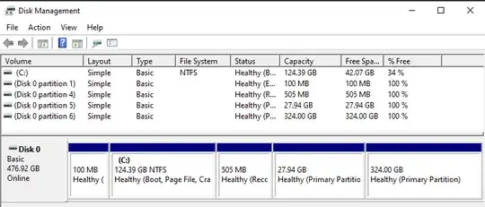

Boot from a USB stick with a live system on it; it doesn't matter much what Ubuntu version or flavour it is. Then try investigating and maybe even mounting that filesystem manually from a shell in that live system. The internal disk might be /dev/sdc now.
You can investigate partitions with any of
sudo parted --list
sudo fdisk -l
sudo blkid
Once you identified which partition your root filesystem is, you can try to run fsck -f on it for a filesystem check.
Try to mount it; I'd start with a read-only mount:
sudo mount -r /dev/sdc42 /mnt
(/dev/sdc42 being the device you just identified as your root filesystem)
then check /mnt/boot for available kernels and if there is a matching initrd* (the initial RAM disk containing kernel modules).
After reading some more comments above, it appears to me that the protective MBR might be a problem. Basically, it attempts to mirror the GPT partition table to make older tools believe they are seeing an old-style PC ("MS-DOS") partition table. That's alright as long as those older tools never attempt to modify any partitions; if they do, however, the protective MBR (which is what they will change) and the GPT (which contains the true information) may start to mismatch.
The result can be that some OS (not Linux, I am pretty sure) writes to disk blocks outside the current partitions and filesystems. If you experience problems after Windows gaming that would be a hint into that general direction.
