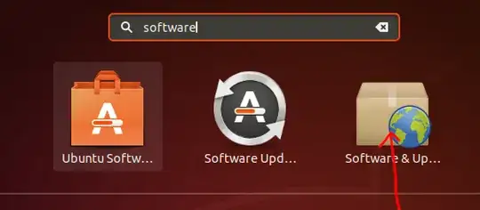

Go to Software and Updates Software and Updates

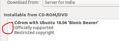

In the Ubuntu Software tab, look for the cdrom, if it’s checked, uncheck it. Ubuntu Software tab
