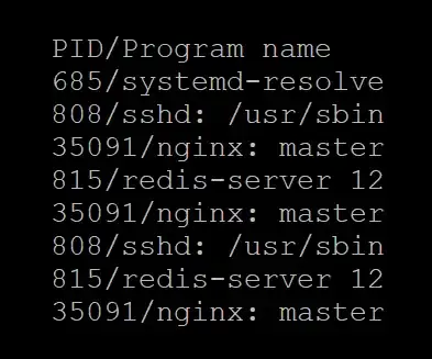

I then tried to see if maybe it was running but not showing with the status command. So I tried netstat -tlnp but I only saw these processes running:
