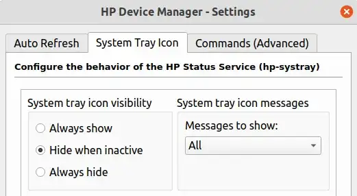

In HPLIP HP printer software, there's an app HPLIP Toolbox (hplip-systray)...

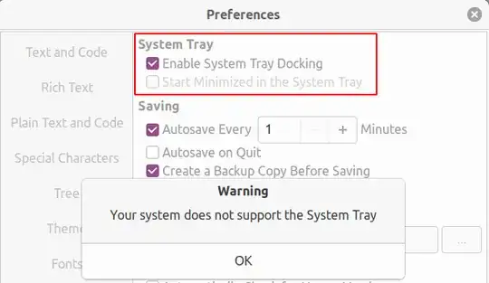

In CherryTree notes...

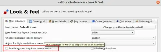

Funny enough, Calibre works...
