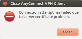

When I try to connect using the Cisco AnyConnect VPN Client, I receive this error:
Connection attempt has failed due to server certificate problem.
I happened to have this problem in my previous Ubuntu 11.10 installation. That time I could fix it using some tutorials on the internet (I don't remember which one). Basically, they suggested installing 4-5 packages and then some ln -s. But this time none of them are working. Can anyone help me step by step?
