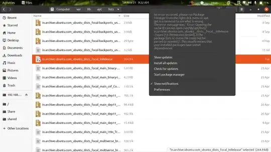

I don't know why I am getting this from some days in the top panel, though it is different every time

Make sure mozilla repo is not longer active.
sudo rm /var/lib/apt/lists/in.archive.ubuntu.com_ubuntu_dists_focal_InRelease
The errors says something wrong with permissions. Try again
sudo apt update
if this is not working
software-properties-gtk
and choose download from main server.
