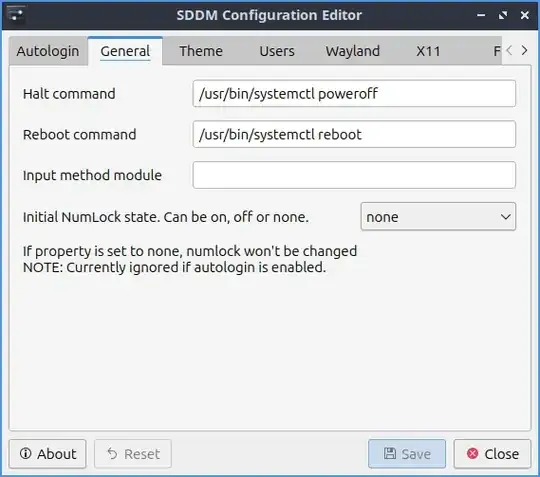

As of Ubuntu 24.04 (noble), there is a sddm-conf package. It appears as "SDDM Configuration" in the app menu.
The General tab of SDDM Configuration Editor has the input method setting.
It does not have any obvious switch labeled "change this to get rid of the on-screen keyboard", but if you leave the "Input Method Module" value blank and save, it will write the config with the InputMethod= line as described by the other answers.
