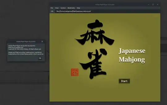

The easiest and most effective way is to download the "Adobe Flash Player Standalone Version" directly from the official source Scroll down for the Linux 32/64-bit version.
I noticed while searching for the provided link, that Adobe is terminating Flash Player
Important Reminder: Flash Player’s end of life is December 31st, 2020. Please see the Flash Player EOL Information page for more details.
