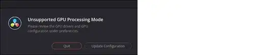

I have installed DaVinci Resolve 17 on my Ubuntu 18.04 machine, but when starting resolve it shows Unsupported GPU Mode error.

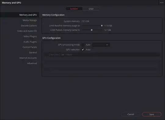

Then in configuration it shows no GPU to select.

I had the same problem, but installing the latest intel-cl drivers as described on the developer-page helped: https://github.com/intel/compute-runtime/blob/master/opencl/doc/DISTRIBUTIONS.md Cheers M

I am using Ubuntu Studio 23.04 on HP running Intel CPU and had the same issue with Resolve not opening. I was able to install intel open cl using Synaptic Package Manager and now Resolve opens! screenshot
