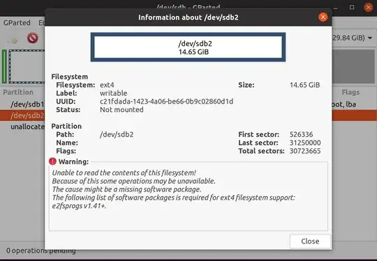

At this point I open GParted just to visually verify my work and I am greeted with this error on partition /dev/sdb2 : link

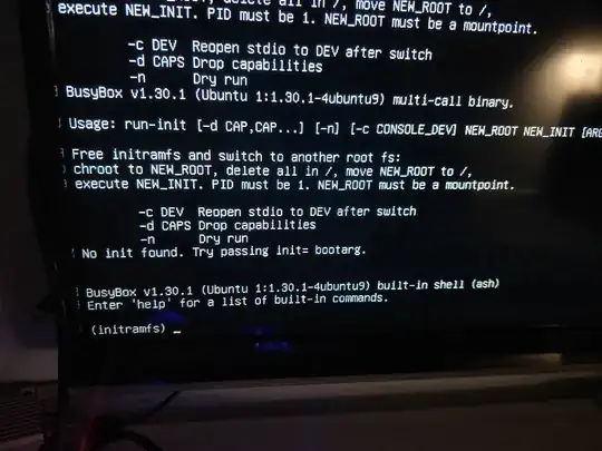

If I now insert this microSD card to my RaspberryPi 4 it fails to boot and gets stuck on this screen: link

I just figured it out myself. After step 7, there is a need for one more step:
  1. After shrinking partition, extend filesystem to the limits of new partition by again running resize2fs /dev/sdb2 without specifying new size.
