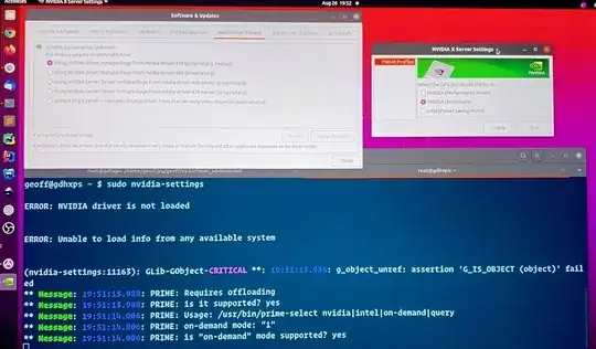

After a system upgrade, GPU infomations are not showing on the NVIDIA X Server Settings (GUI). When I run the command $ nvidia-settings, I gets the error 'NVIDIA driver is not loaded'
My system specs:
Kernel: 5.4.0-53-generic
Ubuntu Version: Ubuntu 20.04.1 LTS
GPU: GeForce GTX 1050 Ti Max-Q
NVIDIA Driver Version: 455.32.00
$ nvidia-settings
ERROR: NVIDIA driver is not loaded
ERROR: Unable to load info from any available system
(nvidia-settings:7943): GLib-GObject-CRITICAL : 17:02:04.348: g_object_unref: assertion 'G_IS_OBJECT (object)' failed Message: 17:02:04.350: PRIME: Requires offloading ** Message: 17:02:04.350: PRIME: is it supported? yes ** Message: 17:02:04.374: PRIME: Usage: /usr/bin/prime-select nvidia|intel|on-demand|query ** Message: 17:02:04.374: PRIME: on-demand mode: "1" ** Message: 17:02:04.374: PRIME: is "on-demand" mode supported? yes

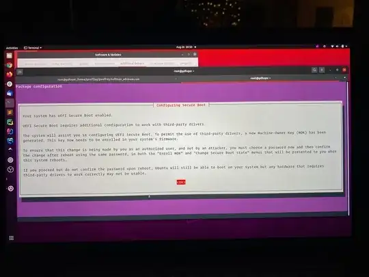

sudo apt install linux-generic
When this command completes, you should get a terminal-ish-GUI shown below. On this screen you integrate/update UEFI and enroll in MOK, by choosing to set a secure boot password. To choose a password, use tab key to switch between the password field and text link.
UEFI Enroll in MOK screen
As soon as that is done, issue a reboot:
sudo reboot now
Upon reboot, you see a blue screen asking if you want to continue boot or Enroll in MOK, which is not obvious, but at that step, pick Enroll in MOK and enter the secure boot password you typed in the prior step.

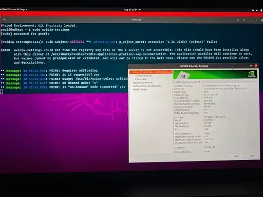

Once you're done, you should see your Graphics card details correctly when running
sudo nvidia-settings
Succesfully loading nVidia drivers under Ubuntu
The screenshot above shows I still have this error:
RROR: nvidia-settings could not find the registry key file or the X server is not accessible. This file should have been installed along
       with this driver at /usr/share/nvidia/nvidia-application-profiles-key-documentation. The application profiles will continue to work,
       but values cannot be prepopulated or validated, and will not be listed in the help text. Please see the README for possible values
       and descriptions.
but the drivers are loaded correctly now. Still researching the impact of the registry key file error.
