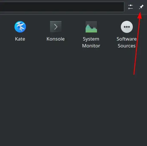

I have noticed that window rules work well if applied correctly. So, pin the launcher:

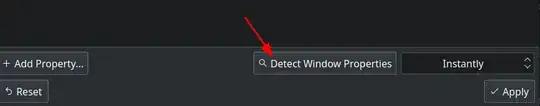

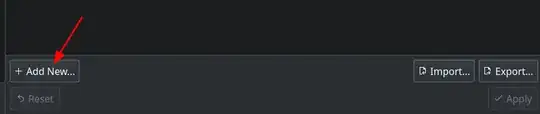

Simply start Windows Rules from the launcher itself, Add New, and then Detect window property.
Then, with the cross-cursor, click the Application Launcher pinned window.

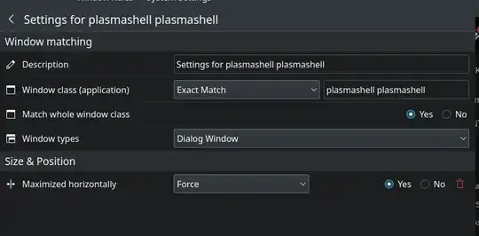

And there, select the first options listed, and also add the Maximized Horizontally property, so that the settings look like the following:
It should work after restart and the other widgets windows should not be affected.
