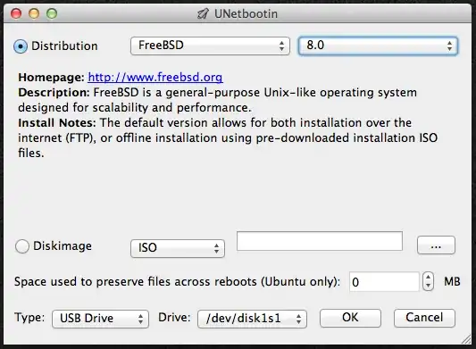

Spent half the day on this but finally have a solution: The application unetbootin will quite happily open up the iso file, extract everything and create a bootable USB stick.
Select your distribution and version
