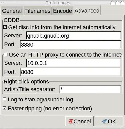

The very latest version of Asunder does not in fact use freedb, having successfully moved the default cddb lookup to gnudb. Older versions of Asunder (versions before 2.9.6) can be brought back to life by changing the relevant settings under:
Preferences --> Advanced --> CDDB
Alter your settings in this location to match the following:
And then all should be well...
