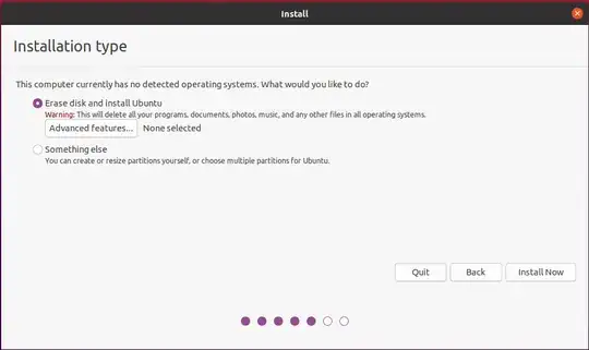

When you get to the installation selection of erase disk or such you'll see something like this:
Installation Type
Choose "Advanced Features" - a new box will open with advanced features.
Select LVM and Encryption like so:
Advanced Features
Hit "OK" then "Install Now" on the original screen where you selected the installation type.

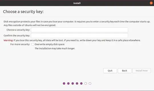

This next window sets your security key for the LVM/LUKS setup:
Security Key Setting

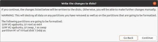

Set your password/key for decryption and hit "Install Now". The next window will look something like this, and you will want to hit "Continue" to install and make changes to the filesystem:
disk changes
Installation continues as normal and expected after this.
