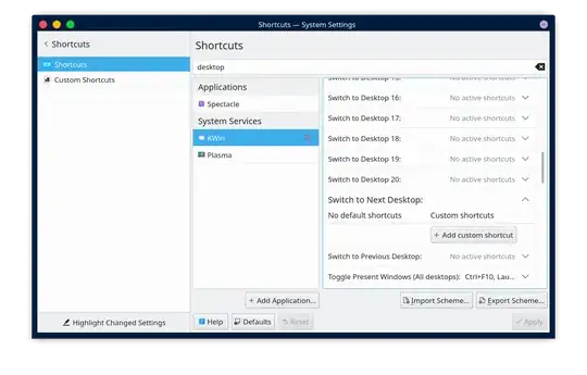

Now you can go to the search bar, type "desktop" and choose "Kwin" from the applications list. On the right you should see a list of shortcuts related to desktop switching. if I was you with just two desktops I would choose the "Switch to next desktop" shortcut, click it, and choose add a custom shortcut, don't forget to apply.
Image of KWin keyboard settings
