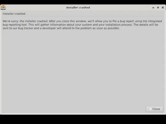

After having used Xubuntu minimal installations from the netboot (mini.iso) image in multiple previous versions of Ubuntu, I noticed that the netboot installer is no longer actively supported. I would like to know what the "official" way is now to get a Xubuntu 20.04 minimal installation in a virtual machine (since Xubuntu is the only official flavor without a "minimal installation" option in its installer). I am aware of the following options with their respective shortcomings:
  • The Xubuntu Core description on the Xubuntu Website still refers to the mini.iso which is not officially supported for >18.04. There is a mini.iso for 20.04 as described in this post, albeit not officially supported anymore. It could disappear any moment or be discontinued completely for future versions >20.04. For now, this image allows me to install a minimal version of Xubuntu.
  • The Xubuntu Core image cannot be installed as the installer crashes (I tried this multiple times since the release and with different versions of VirtualBox): Installer crash
  • Installing the xubuntu-core package via apt on Ubuntu live server, which is listed as the recommended replacement for the mini.iso, yields >4 GB of used disk space and thus seems to differ significantly from the minimal installation performed by the 20.04 mini.iso as well as the 18.04 mini.iso.
  • Ubuntu Core is not an option for me as it requires creating and linking it to a user account. I have not tried it so far because of this restriction. I would just like to install Xubuntu in a VM and use it offline.
  • Ubuntu Base is too minimal and requires a very high number of preparatory steps. I would just like to install Xubuntu.
Given these options, is there anything that I missed which would give me a Xubuntu 20.04 minimal installation in a way that is officially supported and will likely be supported in future versions?

You're right. Xubuntu Core fails to install on VirtulaBox 6.1
At this point, the only option is to be online, create a User ID & then take the machine offline.
Please visit https://core.docs.ubuntu.com/en/guides/manage-devices/ to install Xubuntu Core, in case you want to tweak around this req & create a fresh ISO...
