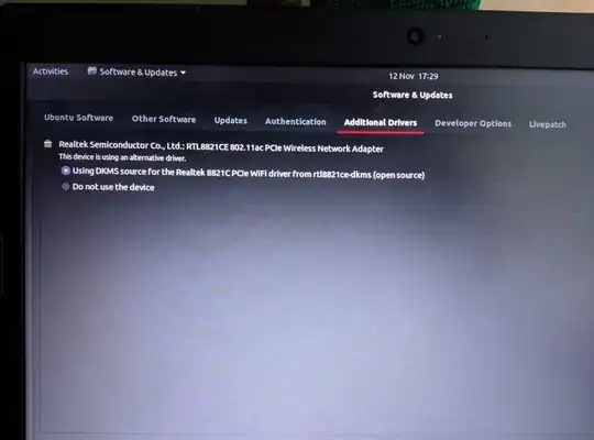

Some time ago one of my friend had the same problem, he fixed it by installing an additional driver for his wifi adapter.
He followed these steps
  1. Open Sofware & Updates application, there you will find drivers for your wifi card
Additional Driver Screenshot
  1. Install it.
Comment in this answer if this works for your (it worked for my friend).
