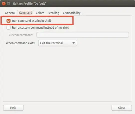

2. Change your terminal window
Now, in order to always load rvm, change the Gnome Terminal to always perform a login.
At terminal window, click Edit > Profile Preferences, click on Command tab and check Run command as login shell.
