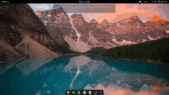

once you are done with copy pasting in the two files. Refresh the gnome-shell with Alt+F2 r Enter method or logout and login.
Then to enable the extension, run below command.
gnome-extensions enable KBD
Again Refresh the gnome-shell with Alt+F2 r Enter method or logout and login.
Now you will see the keyboard button at the top right corner. when you click it, it runs the script you prepared.
