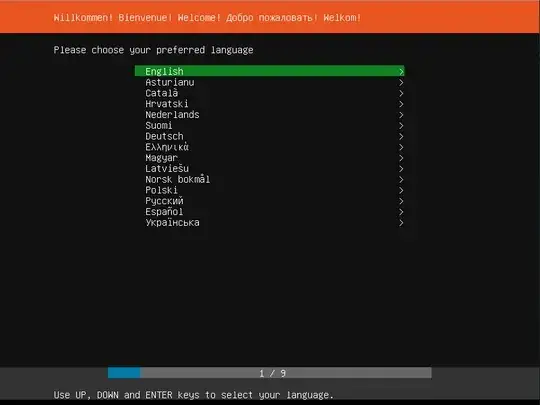

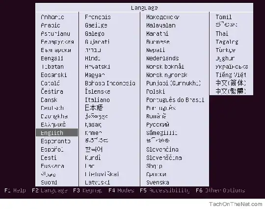

The issue is that when I insert the ISO and boot, it first asks for a language in a purple full screen page and then it goes to a menu that has an option to start the installation.
This is the step that I want to skip, I want it to select English and start the installation.
The next steps work without issue, it installs everything automatically.
The screens that I want to skip look like these:
Note that there is also this screen, but this one is fine, my cloud-config chooses the correct language automatically on that screen:

To remove the choice for languages in Ubuntu editions which would still have it, this is what is needed:
  • remove the file "langlist" from the isolinux directory
  • remove the file "langlist" from the bootloader cpio archive located under the isolinux directory
  • in the file isolinux.cfg located under the isolinux directory, change "prompt 0" for "prompt 10" (this is what I did).
The result : no more choice for languages at the start of the live, and I get to have 30 seconds to change the boot stanza.
Else : I customized the content of the boot stanzas directly in the files txt.cfg (located under the isolinux directory) and grub.cfg (located under boot/grub directory).
