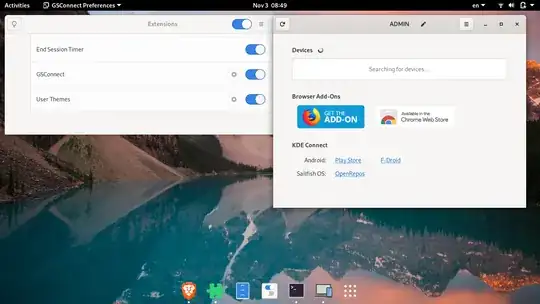

Further, go through this post and concentrate on Installation Instructions. https://askubuntu.com/a/1232696/739431

        Make sure you download the plugin for your browser as well Firefox: https://addons.mozilla.org/en-US/firefox/addon/gsconnect/ Chromium: https://chrome.google.com/webstore/detail/gsconnect/jfnifeihccihocjbfcfhicmmgpjicaec
