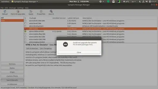

  5. Using synaptic:
    synaptic

I successfully solved this issue with technastic_tc and user.dz.
I had accidentally disabled bionic-updates, I then re-enabled bionic-updates repository from software-properties-gtk.
Voila ! I again tried sudo aptitude install winehq-stable. It worked !!!
Thanks a lot.
