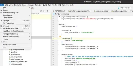

I have multiple versions of Java installed, and I wanted to set which one it used for my Flutter project in Android Studio. All the documentation I can find says to go to File > Project Structure, but I can't find it. My Android Studio file menu
For example, here are some of the places that refer to the Project Structure menu item:
Has this moved to somewhere else? Am I missing it?
I'm just through with the same issue. Probably this should solve your problem too.
Go to Tools > Flutter > Open for Editing in Android Studio
You will be asked to open the Project in the same window or new window. Choose any. Another window will open. There in the File menu, you will find Project Structure.
After you are done with your work you can move back to your original project by going to File > Open Recent
