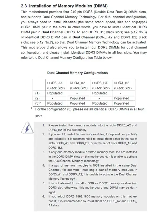

Update #2:
From the ASRock User Manual, we see how to configure the RAM for dual-channel operation. See below...
