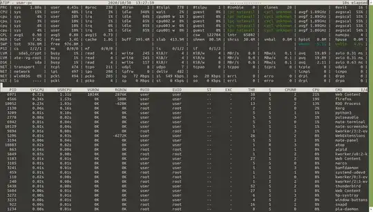

Now, just by typing the command atop in the terminal, you'r shown a lot of information about your system, as shown in the screen bellow.
The relevant sections are the ones preceded by CPU (upper case means the total CPU stats), cpu (lower case means every individual core) and DSK for disk stats. To quit, just type q.

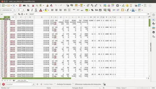

You can redirect the parseable output from atop to a CSV text file, so you can open and edit it in a spreadsheet, to plot graphs of the data you collected, for example:
atop -P CPU,DSK > stats_cpu_disk.csv
When you're done with the data collection, you can stop atop with Ctrl+c, and open the csv file generated in the spreadsheet, using blank space as the column delimiter:
Note the labels for each field are not shown in atop parseable output, but they are given in the manual. Bellow I reproduced the relevant sections:
