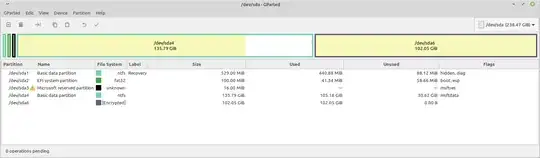

I really need my Windows partition to work immediately, so I am going to focus on that. I got a live usb with Mint 20 on and I can see that all partitions and UEFI files on the Boot partition are there.

GParted overview of my GDT partitioned SSD GParted overview of my GDT partitioned SSD
