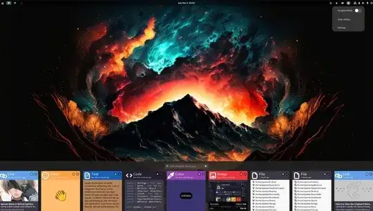

I've released a clipboard manager Gnome extension which is a rewrite of Clipboard Indicator with vastly improved performance, new features, and bug fixes.
Screenshot

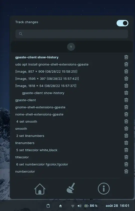

GPaste
You can download it with
sudo apt install gnome-shell-extensions-gpaste
By default the history will by shown by pressing <Ctrl><Alt>H, it can also be called with the command gpaste-client show-history

I really like gnome-shell-pano.
You need to install libgda and gsound for this extension to work.
sudo apt install gir1.2-gda-5.0 gir1.2-gsound-1.0
