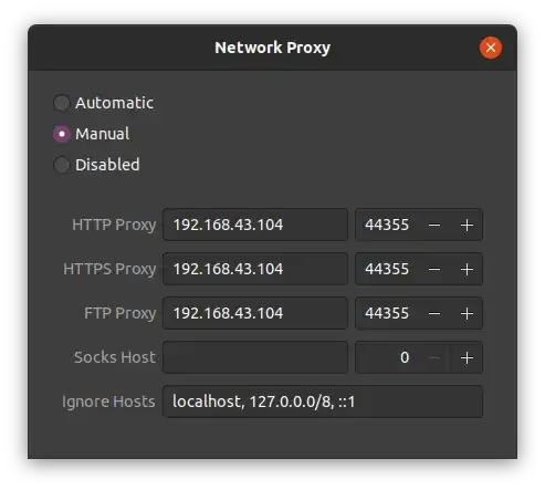

I am using Ubuntu 20.04 LTS and sharing my phone internet connection which is using http tunneling, with my Ubuntu laptop. The app on the phone provides a proxy IP and a port to connect to it's internet. I have added those proxy IP and port on Ubuntu network proxy settings
I can use that Internet connection to browse the Internet and works well on the browser but, cannot use the terminal to update Ubuntu. It gives me this bad request error.

I found some related questions like this, but they didn't help my problem. what is the problem here? (IP address differs from the one in the image because I removed the image and re added code with new result)
the correct way is this:
Edit your /etc/apt/apt.conf and add this:
Acquire::http::Proxy "http://192.168.43.104:44355";
