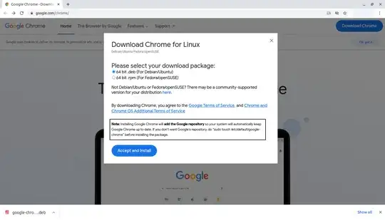

One thing which is crucial to note, which is mentioned before downloading the .deb package from the website, is (emphasis from the original):
Note: Installing Google Chrome will add the Google repository so your system will automatically keep Google Chrome up to date. If you don’t want Google's repository, do “sudo touch /etc/default/google-chrome” before installing the package.
Screenshot of Google Chrome's download page (https://www.google.com/chrome/)
As far as I remember, I didn't execute sudo touch /etc/default/google-chrome before installing the package .
