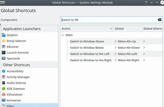

I searched possibilities for this in Global Shortcuts> KWin> Switch ...
and found posibilities to switch beetween Windows left, right, above and below (Super+Alt+left, right, above or below).

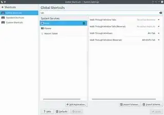

The actions you're looking for are named Walk Through Windows... They are located in System Settings at Shortcuts | Global Shortcuts | KWin.
shortcuts
Note: Search for "walk" or "window" instead of "tab", shown in the screenshot. Searching for "tab" works on my computer because I have it set to use alt+tab, while on your computer, they're "misconfigured".

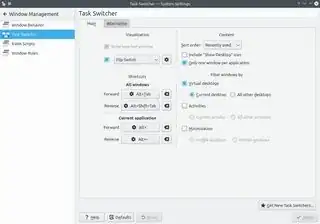

You can also configure the shortcuts in the Task Switcher settings, located at Window Management | Task Switcher.
task switcher
