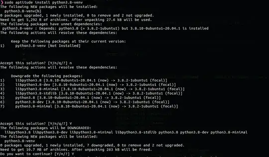

Using aptitude instead of apt-get fixed it for me.
  1. Install aptitude sudo apt-get install aptitude
  2. Now try installing python3.8-venv with aptitude and follow the steps as shown in the below screenshot enter image description here
Once the above steps were completed, python3 -m venv env command worked fine.
