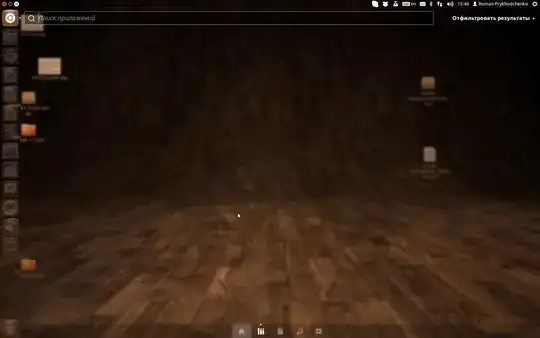

I have ubuntu box that has been upgraded to Ubuntu 12.04. After the upgrade one of the users cannot see applications in the dash:
screenshot

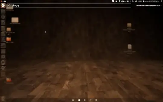

Typing a search query doesn't help: screenshot

I had similar problem, moved zeitgeist directory to zeitgeist.bak and re-login:
mv ~/.local/share/zeitgeist  ~/.local/share/zeitgeist.bak
The problem is that the zeitgeist directory has the wrong permissions. You can also select the folder in Nautilus, and select properties, and make the directory read/writeable for yourself. Then you don't need to log out and in again.

Are the file/directory permissions ok, especially of the ~/.config folder? I've encountered issues myself when updating a ubuntu box and using same username as in the old system. After the update, all files and directories of my user folder had 1001 as owner and group.
