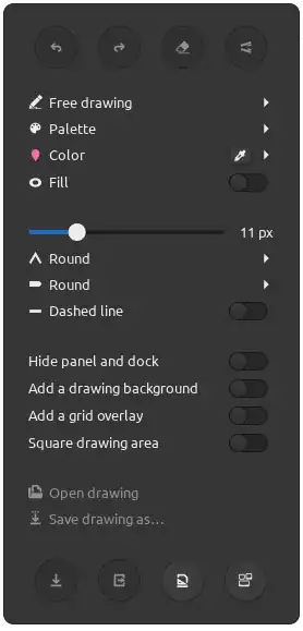

After installing the extension, you can toggle it on and off by pressing Super+Alt+D (this is the default shortcut, you may change it in the extension's settings). There is also a ton of other shortcuts that you can customize in the extension's settings.
The extension offers a plethora of annotation settings, accessible by right-clicking with the extension enabled:
extension's drawing options
Also, here are some useful Tips and Tricks for using the extension.
