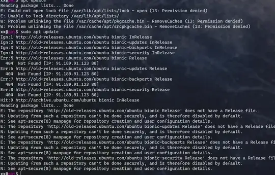

I tried to do an apt update, but I get these errors. Originally I put in the old-release source list. I'm not sure if that messed anything up. How can this be resolved?
Ubuntu 18.04 LTS Bionic Beaver is not an old-releases. It is supported release.
So you have to replace the repo-lines by archive back.
Doing this programmatically is possible by executing:
sudo sed -i "s|old-releases.ubuntu.com/ubuntu bionic|archive.ubuntu.com/ubuntu bionic|g" /etc/apt/sources.list
And then run sudo apt-get update as usual.
